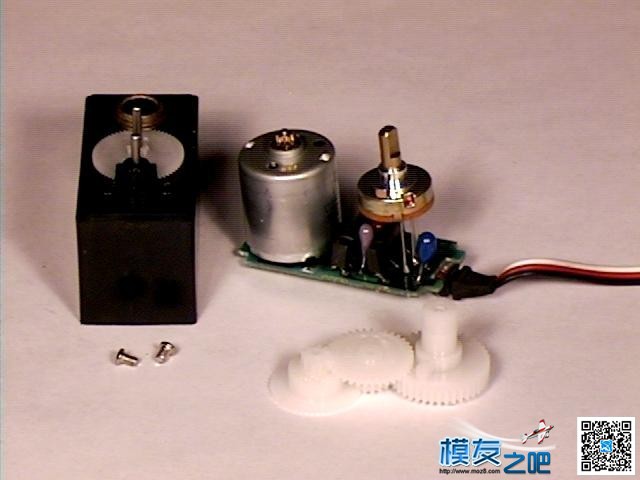

Servos are extremely useful in robotics. The motors aresmall, as you can see by the picture above, have built in control circuitry,and are extremely powerful for their size. A standard servo such as the FutabaS-148 has 42 oz/inches of torque, which is pretty strong for its size. It alsodraws power proportional to the mechanical load. A lightly loaded servo,therefore, doesn't consume much energy. The guts of a servo motor are shown inthe picture below. You can see the control circuitry, the motor, a set ofgears, and the case. You can also see the 3 wires that connect to the outsideworld. One is for power (+5volts), ground, and the white wire is the controlwire.
舵机在机器人技术中极其有用。正如上图所示,舵机体积小,控制电路被集成到内部,相对于其尺寸来说,舵机是极其有力的。例如Futaba S-148这样的标准舵机就拥有42 oz/inches 扭力,相对于其尺寸来说是极其强壮有力的。舵机能够将电能比例化地转化为机械负载,因此舵机在小负载的情况下不会消耗太多的电能。下图展示了一个舵机的组件,包括控制电路,电机,一组齿轮,以及舵机外壳。另外还有三根连接到外部的线,一根为电源线(+5v),一根为底线,白色线为控制线(信号线)。
A servo disassembled.(舵机分解)
So, how does a servo work? The servo motor has somecontrol circuits and a potentiometer (a variable resistor, aka pot) that isconnected to the output shaft. In the picture above, the pot can be seen on theright side of the circuit board. This pot allows the control circuitry tomonitor the current angle of the servo motor. If the shaft is at the correctangle, then the motor shuts off. If the circuit finds that the angle is notcorrect, it will turn the motor the correct direction until the angle iscorrect. The output shaft of the servo is capable of travelling somewherearound 180 degrees. Usually, its somewhere in the 210 degree range, but itvaries by manufacturer. A normal servo is used to control an angular motion ofbetween 0 and 180 degrees. A normal servo is mechanically not capable ofturning any farther due to a mechanical stop built on to the main output gear.
那么,舵机是如何工作的呢?舵机的电机都会有一个控制电路,舵机的输出轴连接着一个电位器(可变电阻)。上图电路板的右上角就是电位器。控制电路通过这个电位器来监视舵机的当前角度。如果监视到输出轴在正确位置(控制电路会根据输入信号来得到正确的角度),就切断电机电源。如果监视到输出轴不在正确的位置,控制电路就启动电机往正确的方向旋转,直到达到正确的位置。舵机输出轴通常能够旋转的行程为180度或210度,但是不同的厂家不一样。普通舵机被用于控制0到180度的角度旋转动作,但是这个角度值的范围受主输出齿轮的机械限位的限制。
