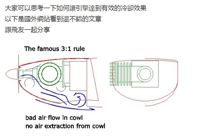

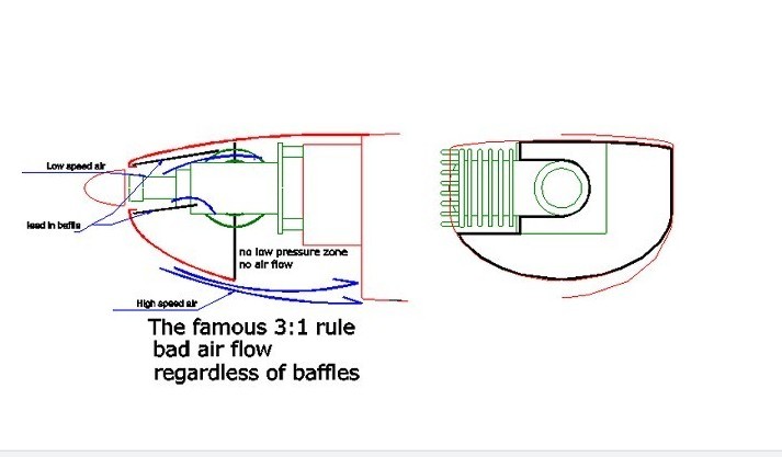

Peter Folmer, who at first sent me in an engine with severe overheating symtoms, gave me permission to publish his data and experience, so others might benefit.
Here goes:
Repair engine, run in "normal glow engine fashion with cowled engine" in a 3D airplane.
The cylinder had turned all shades of yellow. purple, blue and gray, indicating engine temperatures in excess of 300°C. Piston and cylinder were OK, but crankshaft, conrod and all bearings needed to be replaced.
The cylinder head anodize had lost a few shades of hue (color had bleached) due to the heat.
以上是飛友在描述引擎發生嚴重過熱的情況
還有發生過熱引擎出現的變化
這顆引擎高溫達到高溫達到300度
內部機件都已損壞!!該換都換了
其他就沒太多的重點
以下就是重點了
After repairs, he installed a Venom temperature gage, and these are the results:
這是未安裝導風版引擎溫度的狀態
No cowl:
prop 18x6, rpm 9000 static, max temp. 132°C (static and 3D)
prop 16x12, 8000 rpm static, max temp 118°C (Aerobatics)
這是使用導風版後的情況

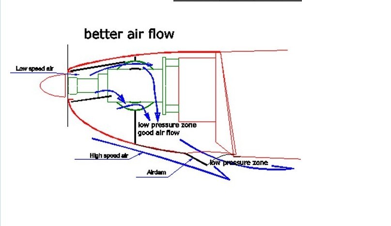

Peter then prepared baffling and a cylinder jacket made from aluminium air ducts. For air extraction from the cowl, louvres were made, and they proved very effective.
In flight: max temperature of 95°C (outside air was at 10°C, so quite cool)
ground running: max temp 100°C
Ground running, changing from 1/2 to 1/1 throttle vice versa, the temperature rose to 85 degrees. when the engine returned to idle, the temp. dropped very quickly to 69°C
For Images of his setup, see next post (soon)
大家也一起來分享您是如何讓引擎達到散熱的方法

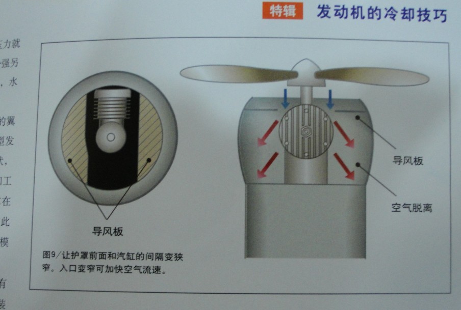

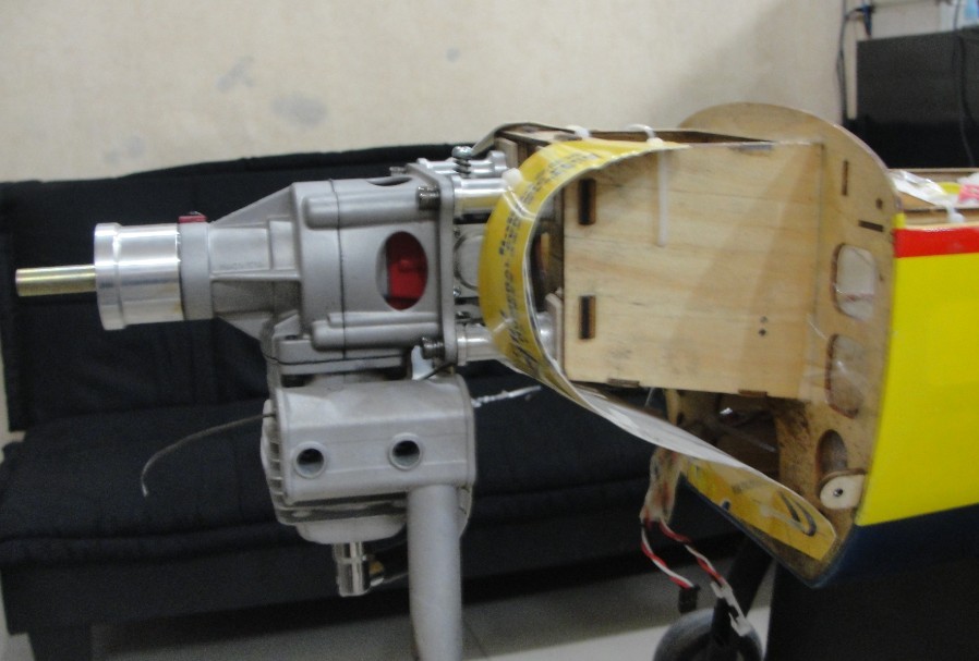

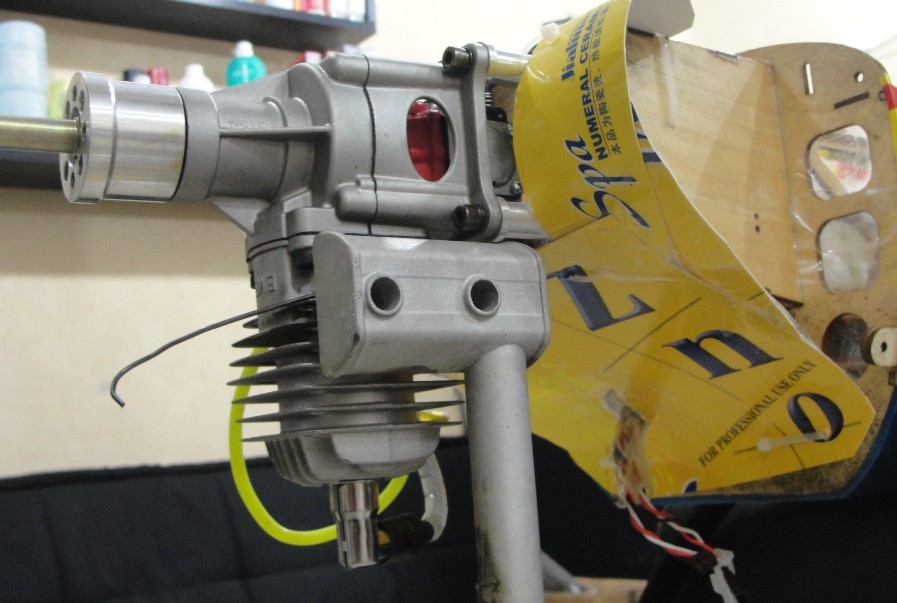

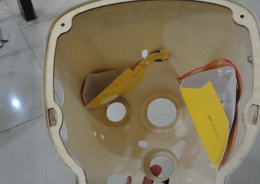

我根据这个帖子自己做的散热器整流板,已经飞了5-6起落暂时无发现 过热情况,继续测试有待观察!
【转热风落雷】如何讓引擎達到有效的冷卻效果! 有效的,热风,落雷 作者:twototoo 7013
【转热风落雷】如何讓引擎達到有效的冷卻效果! 有效的,热风,落雷 作者:twototoo 555
完了加快进气道空气的速度 增加了导流板。

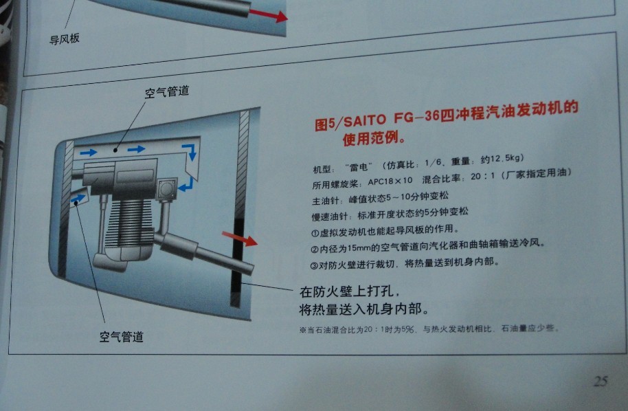

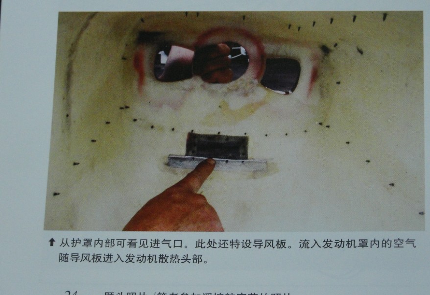

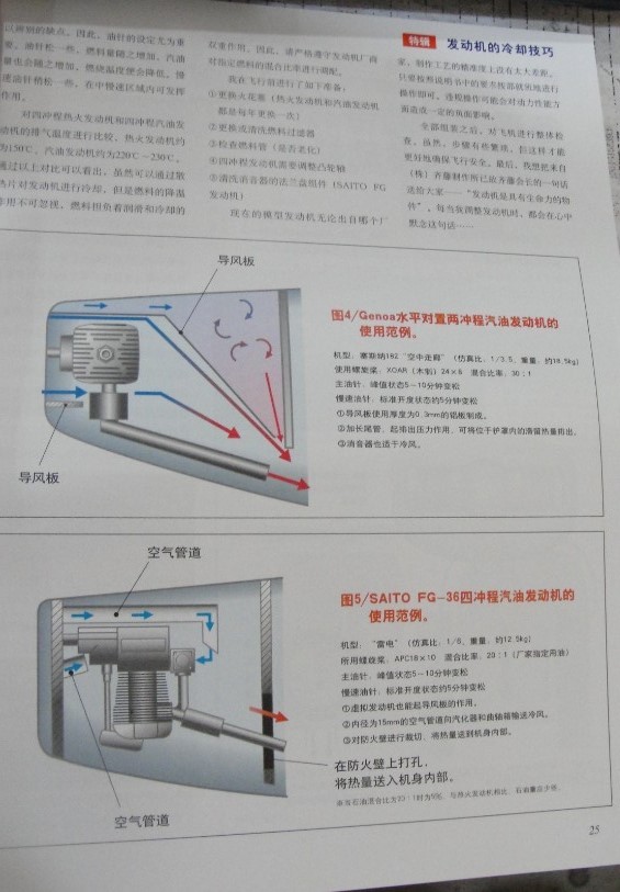

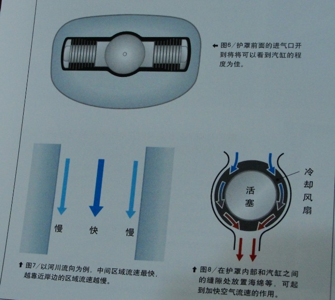

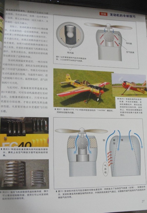

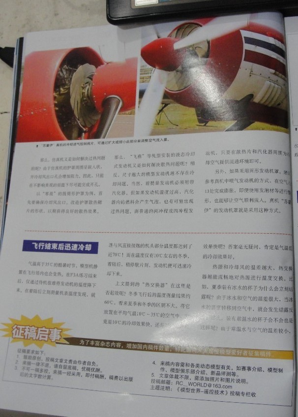

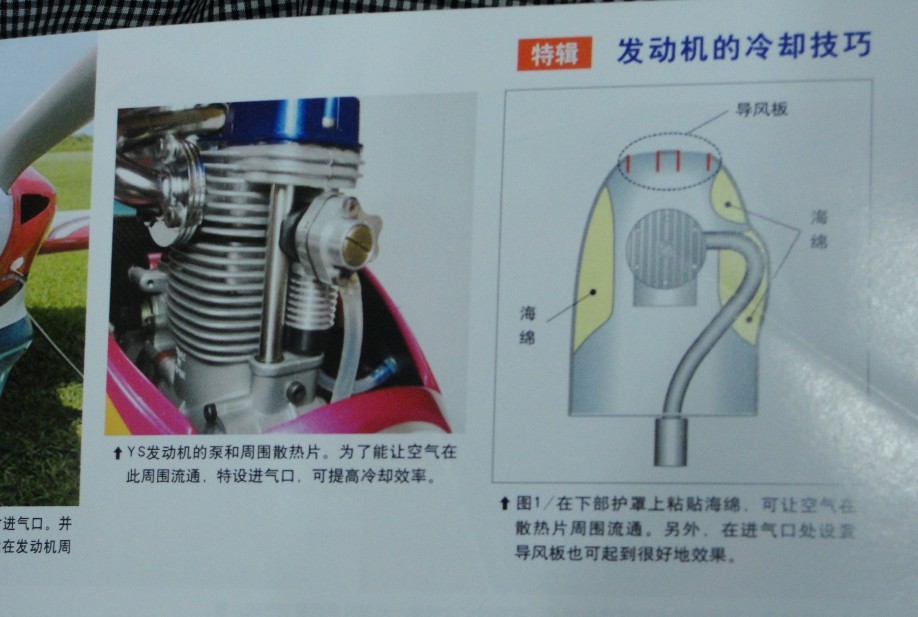

刚买的遥控技术上的介绍分享一下。
