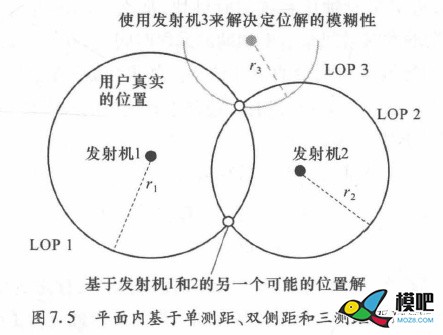

三边及多边测距
用户通过测量三个发射机(基站,或者卫星)的距离来定位自己的位置。最少三个发射机就可以计算用户位置(三边测距),更多的发射机可以使用最小二层方法计算用户位置的最优解(多边测距)

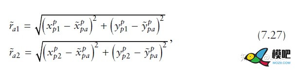

其中:发射机的位置为 <span class="MathJax_SVG" id="MathJax-Element-4-Frame" tabindex="0" data-mathml="(xp1p,yp1p)" role="presentation" style="display: inline-block; line-height: normal; font-size: 16px; word-spacing: normal; overflow-wrap: normal; white-space: nowrap; float: none; direction: ltr; max-width: none; max-height: none; min-width: 0px; min-height: 0px; border: 0px; position: relative;">(xp1p,yp1p) 和 <span class="MathJax_SVG" id="MathJax-Element-1-Frame" tabindex="0" data-mathml="(xp2p,yp2p)" role="presentation" style="display: inline-block; line-height: normal; font-size: 16px; word-spacing: normal; overflow-wrap: normal; white-space: nowrap; float: none; direction: ltr; max-width: none; max-height: none; min-width: 0px; min-height: 0px; border: 0px; position: relative;">(xp2p,yp2p) ,用户设备测得的到发射机的位置为 <span class="MathJax_SVG" id="MathJax-Element-5-Frame" tabindex="0" data-mathml="r~a1" role="presentation" style="display: inline-block; line-height: normal; font-size: 16px; word-spacing: normal; overflow-wrap: normal; white-space: nowrap; float: none; direction: ltr; max-width: none; max-height: none; min-width: 0px; min-height: 0px; border: 0px; position: relative;">r~a1 和 <span class="MathJax_SVG" id="MathJax-Element-6-Frame" tabindex="0" data-mathml="r~a2" role="presentation" style="display: inline-block; line-height: normal; font-size: 16px; word-spacing: normal; overflow-wrap: normal; white-space: nowrap; float: none; direction: ltr; max-width: none; max-height: none; min-width: 0px; min-height: 0px; border: 0px; position: relative;">r~a2 .计算得到的用户位置为: <span class="MathJax_SVG" id="MathJax-Element-2-Frame" tabindex="0" data-mathml="(x~pap,y~pap)" role="presentation" style="display: inline-block; line-height: normal; font-size: 16px; word-spacing: normal; overflow-wrap: normal; white-space: nowrap; float: none; direction: ltr; max-width: none; max-height: none; min-width: 0px; min-height: 0px; border: 0px; position: relative;">(x~pap,y~pap) 。
一般的解法为,先给一个初始的用户位置的初值(预测值): <span class="MathJax_SVG" id="MathJax-Element-3-Frame" tabindex="0" data-mathml="(x^pap−,y^pap−)" role="presentation" style="display: inline-block; line-height: normal; font-size: 16px; word-spacing: normal; overflow-wrap: normal; white-space: nowrap; float: none; direction: ltr; max-width: none; max-height: none; min-width: 0px; min-height: 0px; border: 0px; position: relative;">(x^pap−,y^pap−) ,如7.28所示:

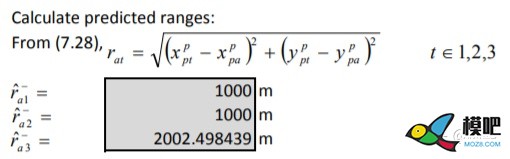

首先计算预测的用户坐标与各个发射机之间的距离:
GPS定位笔记1(三边测量及多边测量,DOP) 仿真,接收机,GPS,算法,导航 作者:杰罗姆 2443

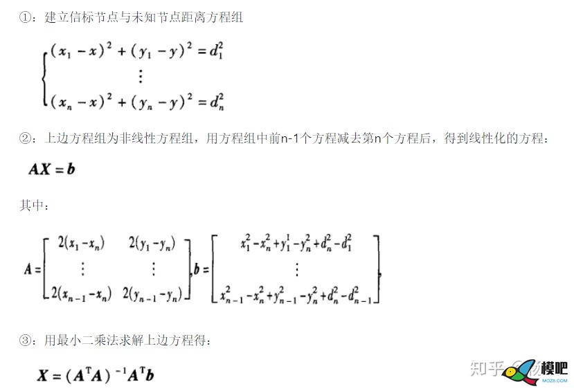

GPS定位笔记1(三边测量及多边测量,DOP) 仿真,接收机,GPS,算法,导航 作者:杰罗姆 1135 另一种多边测距方法:
GPS定位笔记1(三边测量及多边测量,DOP) 仿真,接收机,GPS,算法,导航 作者:杰罗姆 2351 卫星伪距定位例子

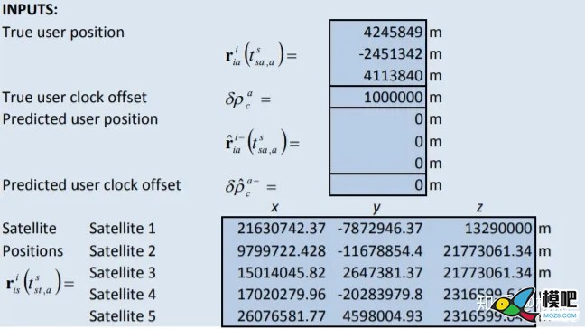

假设有输入如下,给出用户真实坐标,当前估计坐标,估计钟差和 各个卫星位置
GPS定位笔记1(三边测量及多边测量,DOP) 仿真,接收机,GPS,算法,导航 作者:杰罗姆 4694

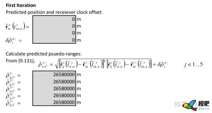

第一次迭代: 计算各个卫星与估计位置的距离
GPS定位笔记1(三边测量及多边测量,DOP) 仿真,接收机,GPS,算法,导航 作者:杰罗姆 1654
