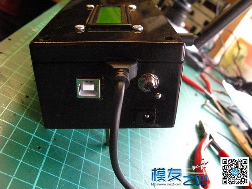

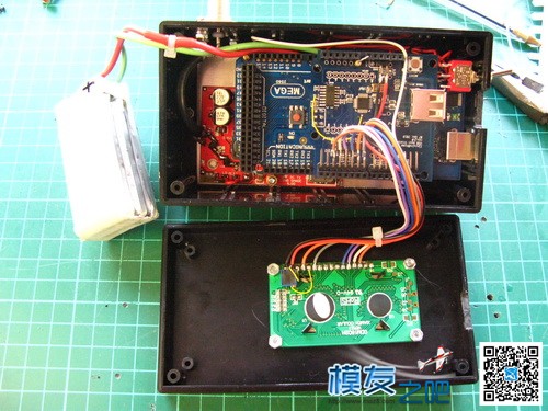

请教飞行摇杆改遥控 飞行摇杆vpc 作者:无机翼的飞机8 5707
请教飞行摇杆改遥控 飞行摇杆vpc 作者:无机翼的飞机8 9545
请教飞行摇杆改遥控 飞行摇杆vpc 作者:无机翼的飞机8 1419
PARTS LIST
The basic parts required:
1 * Arduino MEGA 2560 (MEGA 1280 will possibly work)
1 * USB Host Shield (P/N=DFRobot DFR0138, Circuits@Home Rev 2.0, Tinyos Rev 2 or Sainsmart Usb 2.0)
1 * Logitech Extreme 3D Pro
1 * 16x2 LCD (LiquidCrystal library)
1 * Thomas Scherrer's 430mHz LRS kit (any model will do) c/w antenna, connector & coax.
1 * Battery (i.e. 3S Lipo, 1500mAh, approx. 2hrs contiuious use)).
1 * Enclosure.
