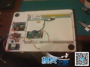

Because of this I decided that I needed a ground station that would save me the need to deal with the assembling
and disassembling in the field and will be more durable then my laptop
对,就是因为这样,所以我决定我需要一个地面站,可以在我要拆装这些零件的时候可以耐用一些,
至少要比我的笔记本耐用......
 楼主| 发表于 2016-3-18 14:03:41 | 显示全部楼层
【原】
First I had to plan my shopping and inventory list
I had an old laptop with a broken screen that did not survive its frequent trips
around and my poor handling skills And an older laptop screen that i planned on
using with the other laptop mother board in order to do it I had to buy a lcd adapter
that will let me use the vga port on the motherboard with the lvds laptop screen
【翻】
首先我要计划一下我的购物清单
我已经有了一个旧的笔电,然而因为频繁的飞行而且我的技术还很渣,所以它的屏幕已经坏了。
蓝后我还有一个更旧的屏幕,为了可以配着另一台笔电的主机板来用,我需要去买一个液晶适配器,
这样我就可以在主机板上装上vga端口 和lvds笔电屏幕.

then i needed to think of a way to install everything in a way that would give me
easy access to the parts just for any case
【翻】
然后我需要想一下怎么安装才能让我在任何时候都能很方便的找到我想找的部件

after trying multiple materials Plexiglas plywood and others which are not
very easy to work with without machinery which i didnt have access to i found
just what i needed a pvc foam it is not the perfect material consider his toughness
which is lacking but it is very easy to work with and so i chose it and start to cut
holes and install the switches and lcds
【翻】
尝试了树脂玻璃胶合板和其他如果没有机器就不适很容易操作的材料后,我发现我需要的
只是一个聚氯乙烯泡沫,这并不是很完美的一个材料,因为它的韧性并不是很好,但是很容易处理,
所以我最后选了这种材料,然后就开始裁剪、安装开关和显示屏了。

【原】
some technical details:
for powering the station i chose to use a sla battery instead of lipo for some reasons
first it is easier to deal with in terms of charging it and is much safer then lipo
second it is cheaper and heavier so I can save money and use it for balancing the case
【翻】
一些技巧:
电池我用的是sla 而不是 lipo, 原因是:
首先sla充电起来比较方便,也比较安全
第二,性价比高,省钱
第三,sla会稍微重一点,这样箱子就可以平衡一些
 楼主| 发表于 2016-3-18 15:20:47 | 显示全部楼层
【原】
i also wanted to be able to hook the station to ac power when its available
so i searched for some ac/dc converter that will meet my power demends and
it turned out that i missed it in my calculation by a bit but for the moment it is working
and i see no reason to change it but when it brake i'll certenly buy a bigger one capable
of outputing more current
【翻】
我还想用交流电力,所以我找了一些交流电/直流电的转换器,然而用了之后我觉得我应该多考虑下,、
然而目前他正在工作,然后我觉得没理由把它换下来,但是如果它坏了我会买一个能输出更大电流的。

发表于 2016-3-18 18:36:51 | 显示全部楼层
小茑 发表于 2016-3-18 14:34
【原】
very easy to work  ...
散热不好吧
