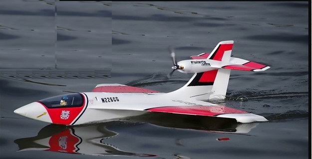

1..北极星水机空机一台
2.天地飞6通道遥控器(配接收机)一台
3.马达:2212-1400kv*1
4.无刷电调ESC:无刷40A*1
5.舵机:9G舵机*3
6.电池:3S 2200mah 20C*1

真漂亮好飞吗?多少米?
 楼主| 发表于 2013-3-22 17:22:52 | 显示全部楼层
admin 发表于 2013-3-22 06:57 EPO北极星水机 EPO,北极星像什么,北极星是什么 作者:ztx 8057
真漂亮好飞吗?多少米?
400左右

轉載:EPO 北极星水机..最 新图片和视频。
Specifications
Wingspan: 34”
Length: 46”
AUW: 36-38 oz.
Wing area: 471 sq in
Wing loading: 11.6 oz/sq ft
Power Requirements:Motor: 2810-9 or equivalentKV: 1350ESC: 40 to 50 amp, switch mode BEC recommendedProp: APC 8 x 6 or Master Airscrew 8 x 6 three blade on 3S, APC 8 x 4 on 4SBattery: 3S or 4S 2200 to 2500Power output: 280 to 450 wattsServos: 9 to 13 gram servo with torque rating of 16 to 25 oz/in
