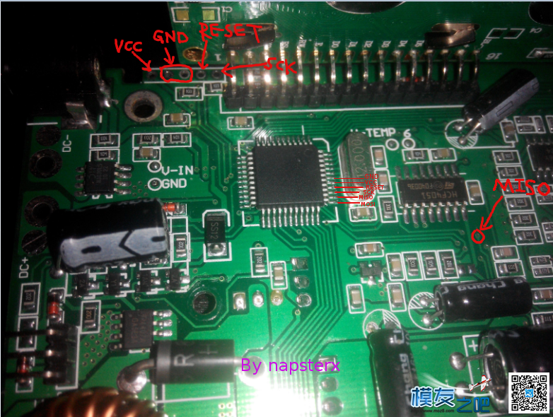

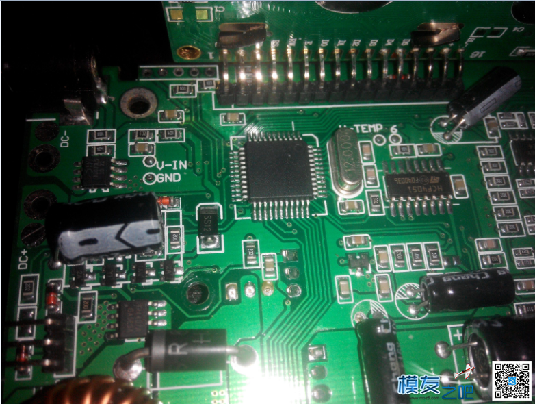

买了非常便宜的B6,结果呢,连个芯片都没有写是什么样的。
准备刷机。。。

 楼主| 发表于 2015-11-25 12:40:42 | 显示全部楼层
长这样。最新山寨B6刷机教程? 便宜,资料 作者:napster 8857
还有
最新山寨B6刷机教程? 便宜,资料 作者:napster 6055
真是够省的啊。连个芯片都不去印丝了。。
都不知道哪个是哪个。。害得我拿着 万用表, 一根一根线逆向来判断脚针。。也还没有找到这样的教程。。然而不知道如何刷。。
这款的B6真是省到家了。。。
 楼主| 发表于 2015-11-25 12:48:16 | 显示全部楼层
马蛋。找到了 编程口了。。
最新山寨B6刷机教程? 便宜,资料 作者:napster 2853

 楼主| 发表于 2015-11-25 12:58:41 | 显示全部楼层
最新山寨B6刷机教程? 便宜,资料 作者:napster 3925

 楼主| 发表于 2015-11-25 13:32:05 | 显示全部楼层
找到了这款芯片的 pinout。
如图:
(需要翻嫱)
最新山寨B6刷机教程? 便宜,资料 作者:napster 119
发表于 2015-11-25 13:34:16 | 显示全部楼层
napster 发表于 2015-11-25 12:48
马蛋。找到了 编程口了。。
ISP口不在你板子左上角那六个2.54的排孔吗,对应找下顺序就好了
 楼主| 发表于 2015-11-25 13:35:23 | 显示全部楼层
引用google groups上一些人的思路 zap parello
Hello!
I have absolutely same charger and I'm trying to find what microcontroller it uses.
You have a error in your pinout: the XT1 pin 4 is not connected to anything.
Pin 3 is connected to GND, this is correct.
Also one can observe that the right row of pins on the microcontroller (pins 34-44) ressembles very much the pins 1-11 of a regular atmega32.
The crystal is placed at the same pins, GND and VCC are at the same pins, and pins 36 and 37 are "SCK" and "RESET" on atmega32 which is logic to put on the programming connector.
However, MISO and MOSI are not connected to XT1, which is strange.
Also there are no GND/VCC pins along the other three sides of the microcontroller.
So, I suppose this could be some old Atmel microcontroller. Possibly, the chinese guys found a source of some very cheap very old microcontrollers and implemented an IMAX on them.
This is very laudable from nature protection point of view :-]
推测这个应该是便宜的老款芯片,或者是大陆仿制的atmega32芯片。
 楼主| 发表于 2015-11-25 13:36:24 | 显示全部楼层
那不是6个。是5个。这个板子不是一般的板子。跟市场上绝大多数不一样。你都不知道芯片是哪里出的。
 楼主| 发表于 2015-11-25 14:01:44 | 显示全部楼层
看到Google Groups里的Matthius 这么悲观的说,
Mine is terrible too, and I can't calibrate it. The seller is not able to say me what is this MCU. That's why I bought a new one, with a known MCU, that I'll be able to flash and so to calibrate =)
I bought a B6, I'll just switch the board with my B6AC and throw the bad one.
大陆的山寨厂,还自己换不一样的芯片,拿出去卖。用户也不知道是什么芯片,一些工程师都逆向还找不到合适的MCU,费了半天功夫,对不上号。
由于这种充电器的B6芯片对不上(大陆的某款不知名芯片),也不能刷上开源固件,所以就这样不能校准充电器。。让人很无奈。他们都是在ebay和amazon上买的,不好用就扔掉。再买一个,基本上没有换货的。。问商家,商家也不说是什么芯片来的。呵呵~
 楼主| 发表于 2015-11-25 14:06:20 | 显示全部楼层
hddhy 发表于 2015-11-25 13:54
如果是5个口子的话,那极有可能是新唐M0517的芯片,刷机比较麻烦,楼主可以尝试下,刷成功了功德无量呀{:1 ...
一定不是M0517,对了半天脚针都不对。新唐的不出11脚针的MCU,把他们的datasheet看了一遍,还没发现。
下面是我做的脚针分析图。
提供大家使用。
最新山寨B6刷机教程? 便宜,资料 作者:napster 9193
有需要的,可以尝试下,看看能不能刷上。
市场上大多数的山寨B6用的mega32, M0517的固件都不能刷。鉴定完毕。
我给这个山寨B6 命名 山山版B6充电器。是在山寨的基础上再次山寨降低成本以至于都不能友好地hacking了,可以说是样子货
