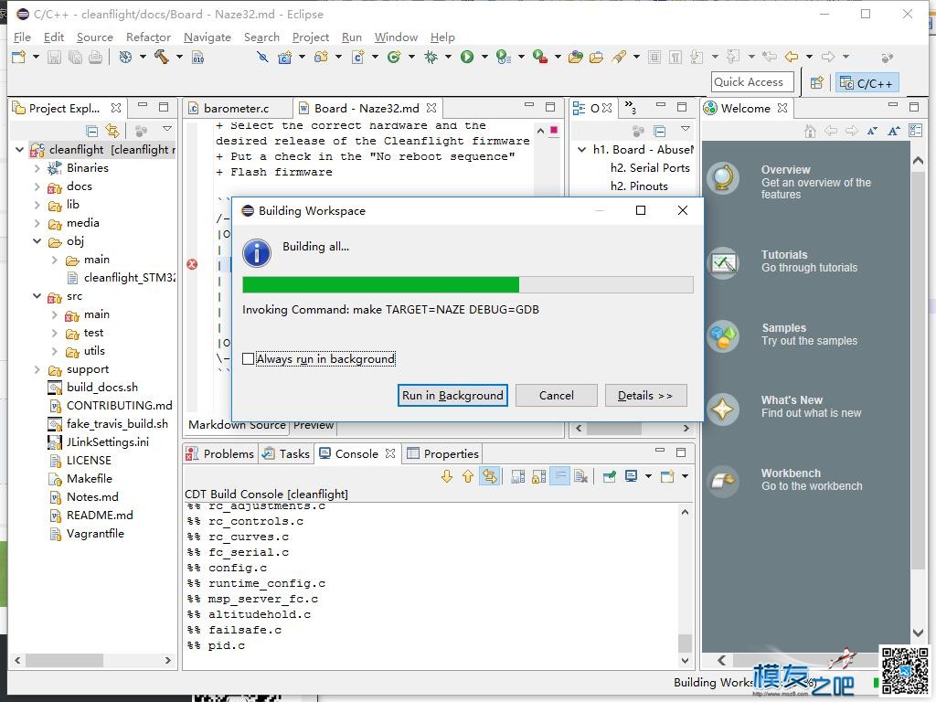

用eclipse搭建编译cleanflight-master出错,请大神指点。
以下是出错的信息
01:53:17 **** Incremental Build of configuration Default for project cleanflight ****
make all
Building file: ../support/stmloader/loader.c
Invoking: Cross GCC Compiler
gcc -O2 -g -Wall -c -fmessage-length=0 -MMD -MP -MF"support/stmloader/loader.d" -MT"support/stmloader/loader.o" -o "support/stmloader/loader.o" "../support/stmloader/loader.c"
Finished building: ../support/stmloader/loader.c
Building file: ../support/stmloader/serial.c
gcc -O2 -g -Wall -c -fmessage-length=0 -MMD -MP -MF"support/stmloader/serial.d" -MT"support/stmloader/serial.o" -o "support/stmloader/serial.o" "../support/stmloader/serial.c"
In file included from ../support/stmloader/serial.c:29:
/usr/include/sys/select.h:28: error: parse error before "fd_set"
../support/stmloader/serial.c: In function `initSerial':
../support/stmloader/serial.c:39: error: `O_NOCTTY' undeclared (first use in this function)
../support/stmloader/serial.c:39: error: (Each undeclared identifier is reported only once
../support/stmloader/serial.c:39: error: for each function it appears in.)
../support/stmloader/serial.c:39: error: `O_NDELAY' undeclared (first use in this function)
../support/stmloader/serial.c:46: warning: implicit declaration of function `fcntl'
../support/stmloader/serial.c:46: error: `F_SETFL' undeclared (first use in this function)
../support/stmloader/serial.c:35: warning: unused variable `brate'
../support/stmloader/serial.c: In function `serialAvailable':
../support/stmloader/serial.c:154: error: `fd_set' undeclared (first use in this function)
../support/stmloader/serial.c:154: error: parse error before "fdSet"
../support/stmloader/serial.c:157: warning: implicit declaration of function `FD_ZERO'
../support/stmloader/serial.c:157: error: `fdSet' undeclared (first use in this function)
../support/stmloader/serial.c:158: warning: implicit declaration of function `FD_SET'
make: *** [support/stmloader/serial.o] Error 1

头文件找不到, 绝对是 include path 的问题。
我不进一步帮你了(毕竟要花很多时间配置环境,找问题)
在eclipse编没多大意思,  eclipse不过也调用 gcc的命令罢了,
你按照 cf 的编译的 readme 慢慢来。

 楼主| 发表于 2016-11-13 11:43:45 | 显示全部楼层
在e ...
你好!CF的编译在哪里?没有看到,请给指点,谢谢!
http://www.moz8.com/thread-60361-1-1.html (要知道细节要看 Makefile, 我还没具体研究)  详情 回复 发表于 2016-11-13 15:55
发表于 2016-11-13 13:14:50 | 显示全部楼层
路过。。
发表于 2016-11-13 15:55:58 | 显示全部楼层
 楼主| 发表于 2016-11-13 17:47:51 | 显示全部楼层
已经在WIN10下顺利编译了CF,接下来会尝试仿真.
没图没真相,上图咯!
