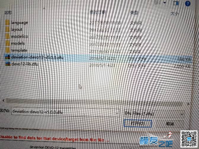

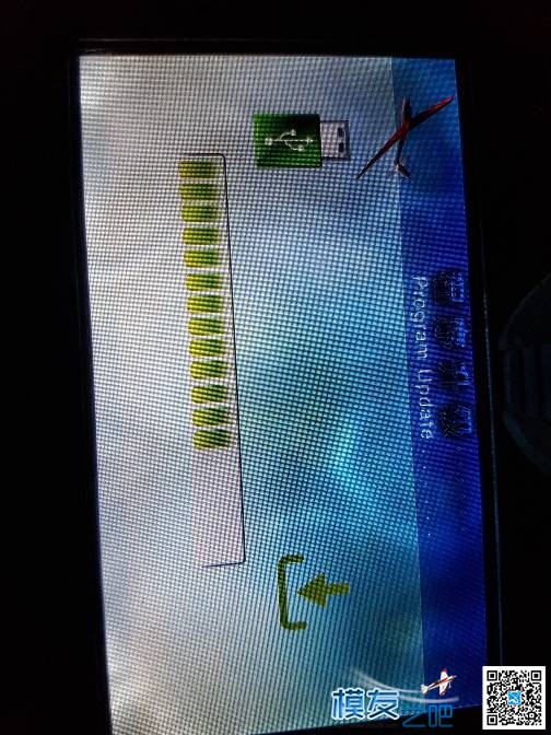

请问哪位大佬知道devo 12s怎么刷deviation5.0.0
我刷完之后开机就显示USB模式了,是不是我刷的方法不对??

只刷过D10还有D7E,
D12S好多功能更高端了,是不是因为你没把文件系统拷贝进去,所以刷完机第一次开机自动进入usb模式等你复制文件系统进去啊
你看看复制进去以后是不是就不这样了

我已经把文件复制进去了

我是不是刷错了

发表于 2017-8-31 09:40:28 | 显示全部楼层
1.Press the ‘…’ button and select the deviation-devoXX-vx.y.z.dfu file to install.
2.Select ‘Upgrade‘ to install the firmware. This will be grayed-out if your transmitter is not detected. Do NOT use ‘Upload’ as this will destroy the dfu file on your PC.
3.Devo12 Only: Select the ‘Library’ tab, click ‘…’ select the devo12-lib.dfu from the zip file. Then select ‘Upgrade‘ again to install the library.
官网找到的资料,D12还要把devo12-lib.dfu 文件也刷上去才能用

谢谢老哥,昨天晚上在deviation论谈找到了方法搞定了,再次谢谢老哥热心帮忙
